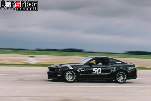

Nope, the 10" doesn't stick out on front. We developed that fitment to work on both front are rear with the same offset. Here are 18x10 with 295 tires.
What diameter are those 295s?

They are a 295/35-18 which should be just a touch over 26" tall.
