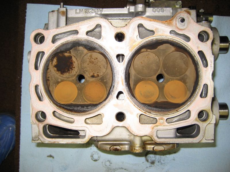

BTW: I wouldn't run Torco in my lawnmower!
Unless you want your heads to look like this from all the MMT.

So every car looks like that or that happen to one car and they happen to run torco. If that happens to everyone then wouldn't they be out of business and no performance shop would sell it?

Not really, because it's an after thought for most people. If you run Torco, your motor will look like that in time. It's a by-product of Torco.

Every car will look like that with prolonged use of Torco. This is nothing new. It will turn your plugs, valves, heads and exhaust brown.
Over time, the MMT will build up in the cylinders and could lead to "Hot Spots" if and when Torco is not used.
It won't hurt my feelings if you don't want to run E85. I just want to help you understand there are drawbacks with anything.

On Torco, I suggest changing your plugs and oil often(more so than usual). Especially after nights at the track where you are spraying it a lot. Torco was all the rage back when the Terminators first came out. I had a couple of Terminator friends who will go unnamed (haha!) that used Torco so much that one blew a couple of motors and another one who had a plug seize up in the head due to it being so corroded from not changing them often enough on Torco.
